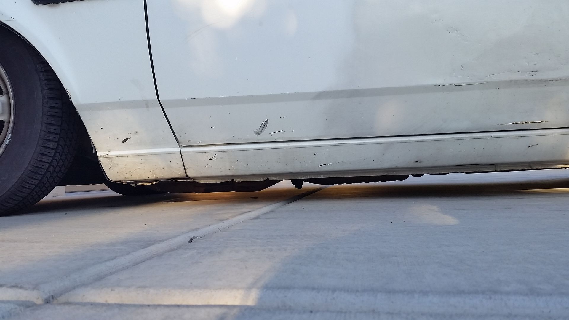

« Reply #24 on: December 10, 2014, 07:37:15 PM »
I put on the driverside coilover(didnt have time to do both)
what a pain in the ass.
I couldnt get the bolts out from underneath the spindle.
i hit it with my cordless impact,nothing.
got it with a ratchet,nothing.
small breaker bar,nothing.
I had to use my big breaker bar and even that took awhile lol
.86 stuff fits 82/83 corollas but not 80 or 81.
so the holes up top were off a little bit.
i ended up ovaling the holes to get it to fit.
reassembled everything and dropped the car.
then i noticed the damn wheel was pushed all the way up against the coilover..so i slapped on a 25 mm spacer lol
The car sits pretty low and i still have an inch of adjustment.ill see where i want it when i get some wheels for it.
ill do the other side tomorrow and post more pictures
Re: 80 sedan
« Reply #25 on: December 11, 2014, 07:31:00 AM »
That is a low mofo
Re: 80 sedan
« Reply #26 on: December 11, 2014, 07:59:45 AM »
Oh yeah I'm really starting to like this setup

Re: 80 sedan
« Reply #27 on: December 11, 2014, 10:38:39 AM »
Damn, I thought I was low! lol What're the rates on those coils?
The legendary pizza delivery 8-6 of Akina.
Toywagon82
  • Posts: 278
Re: 80 sedan
« Reply #28 on: December 11, 2014, 02:29:41 PM »
It still looks a bit funny because the front passenger side is on stock suspension lol.
the fronts are 8k and the rears are 6k
