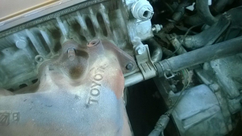

Cut off! Someone very much despised the idea of having to implement a breaker to remove the two outer bolts on the exhaust mani and decided to do this!

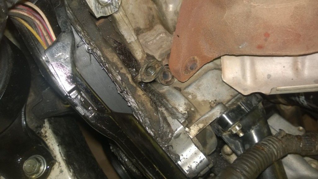

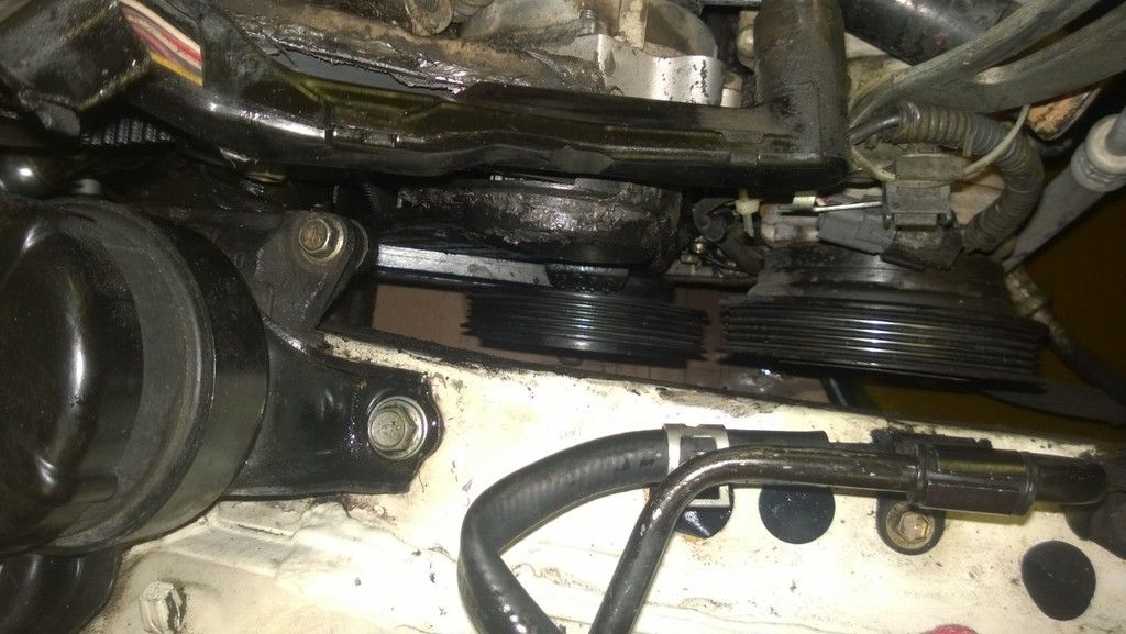

Well-oiled! No, seriously! There's oil all over EVERYTHING!!!

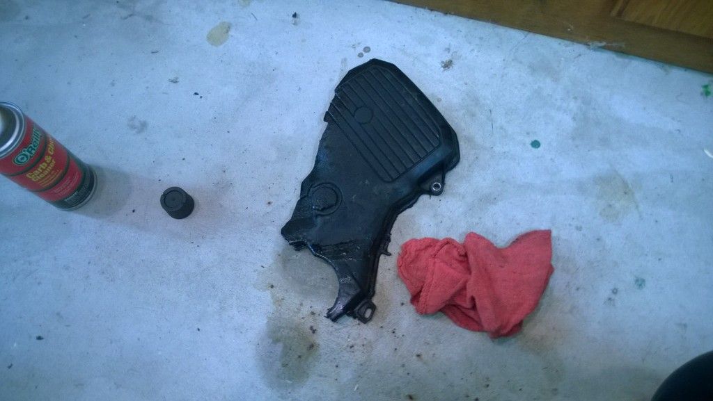

AZT, meet my new friend, Timing Cover! Or what's left of it. I found pieces jammed up in a bit of everything. This is the only solid piece left...with no gasket left to speak of.

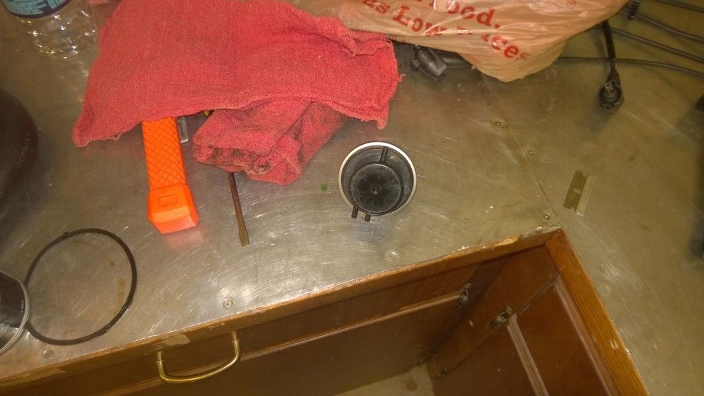

I like this game! I'm going to keep going with these fun little horror stories as this unravels. In the meantime, can anybody tell me what this part is called? I'm about 120% sure it has everything to do with my CEL firing up vacuum codes. The top popped right off and revealed the nastiest mountain of goop and sludge I have ever seen, smelled or accidentally tasted.

EGR modulator.
You could be right.

Awesome! Thanks! Gonna grab one of those and a timing cover today!
