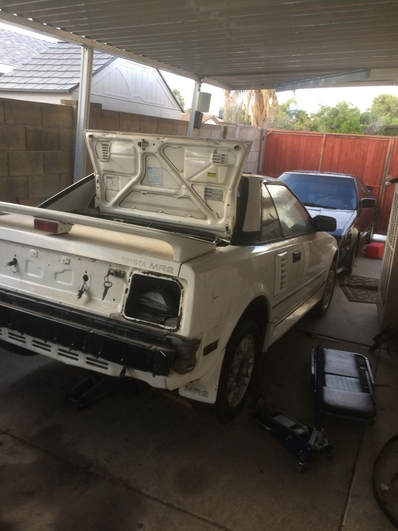

Ok, I've been slacking...
I am slowly building the white MR2.
I am building it for what I need.
and what I need is a simple daily driver with A/C, great fuel economy and an automatic transmission.
I drive across town twice a day, so a twincharged project car isn't what I need.
This car has been sitting around as I slowly rebuild a stock engine for it.

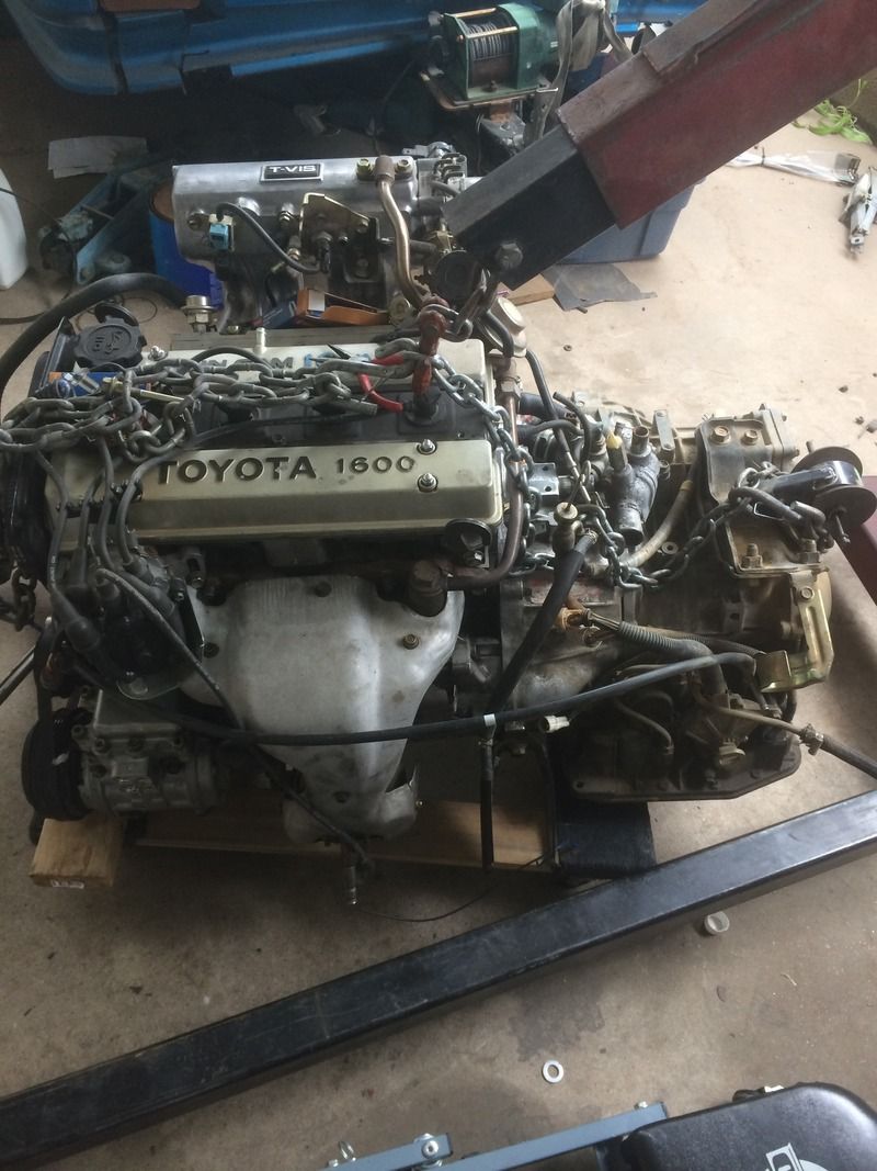

The Two Twos
Building a stock 4age.  It has one replaced piston and rod, new rings, bearings, oil pump and water pump.
New head gasket and seals.

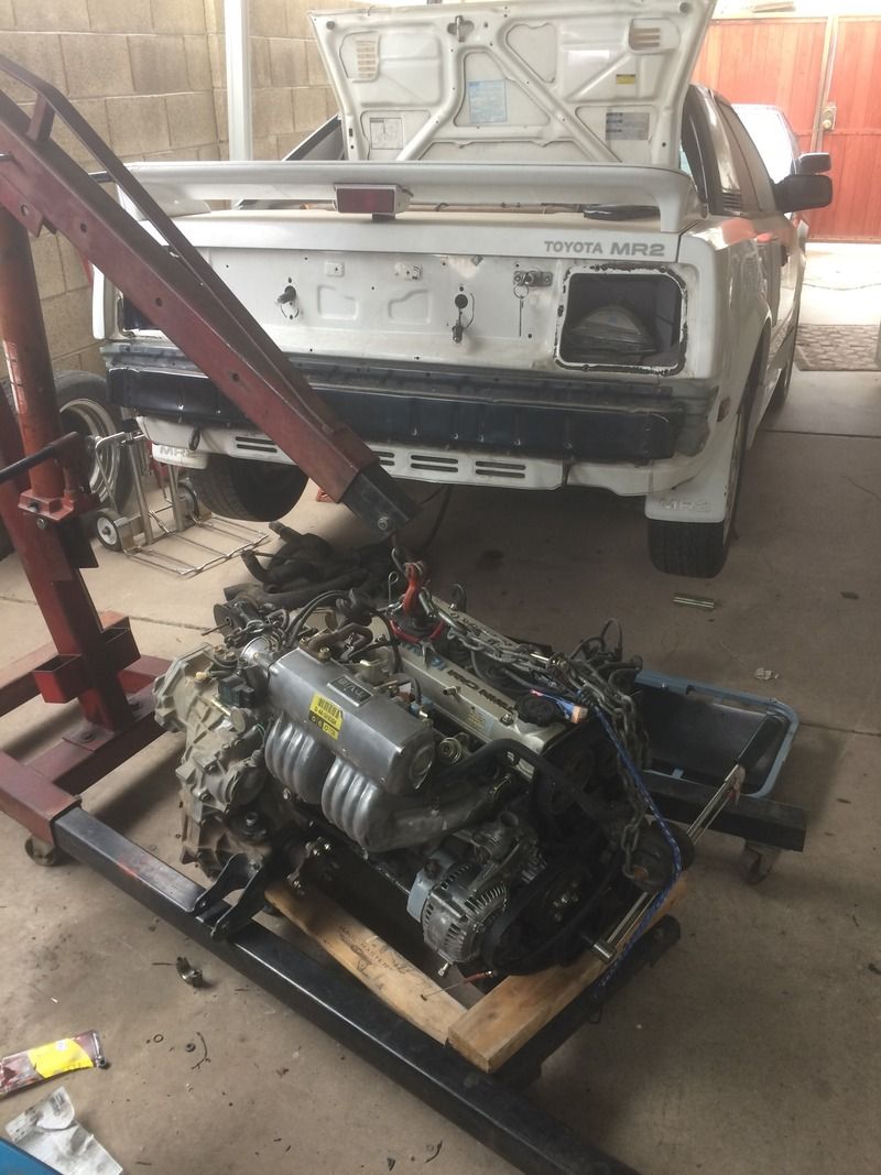

I didn't take pictures as I was putting it together.

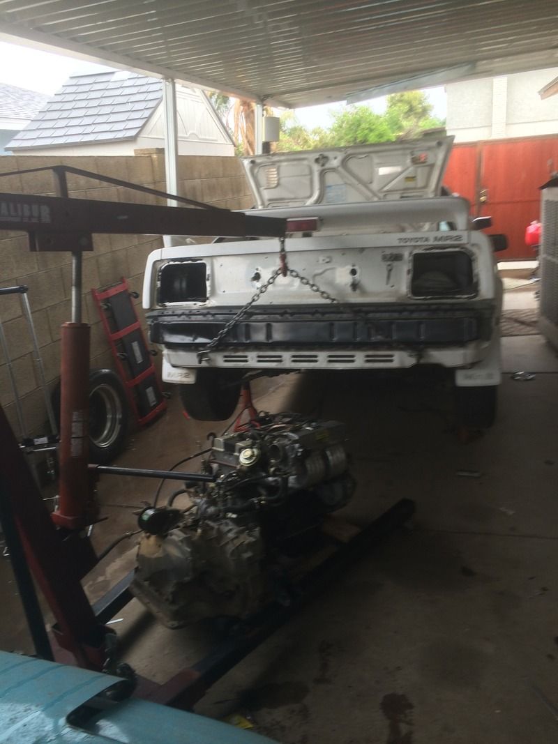

Yes, an auto transmission....
Almost ready to drop the car on top of this...
That's what you do, you lift the car, push the engine/trans underneath it and then lower the car.
It will be something new for me.

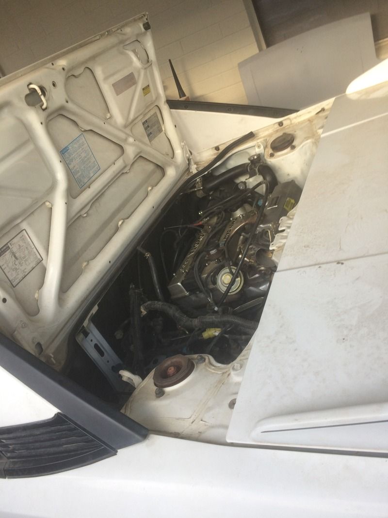

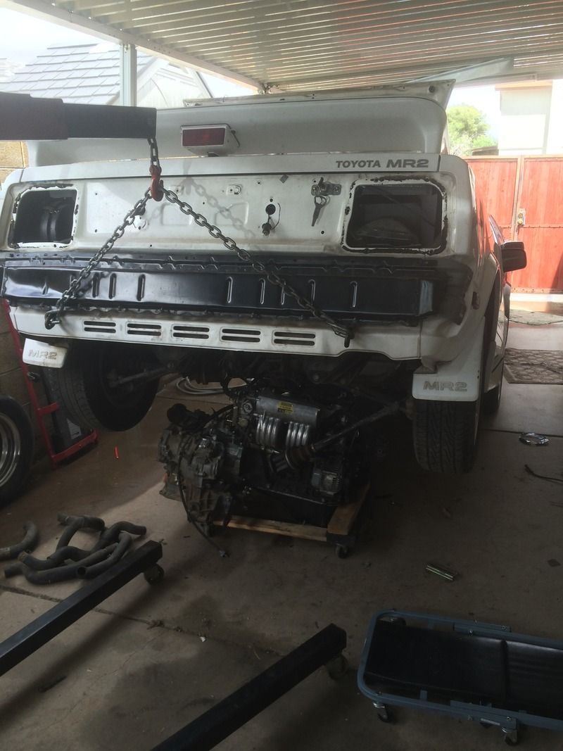

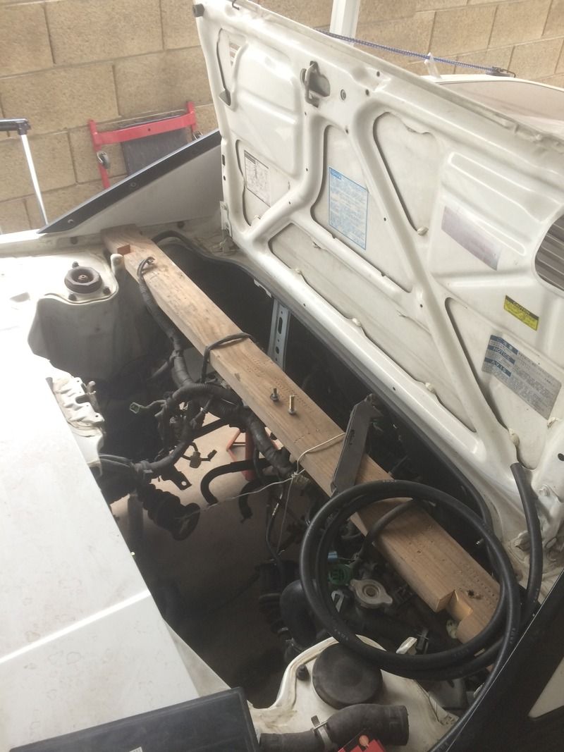

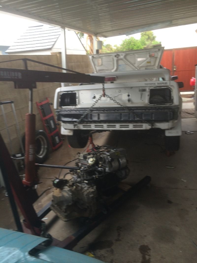

So, more slow progress on the MR2,
I was ready to put the engine in, then I noticed that I had the wrong oil pan on the engine, so I had to swap it out.
Pretty sure it is all ready to go in now, transmission is bolted on and everything..

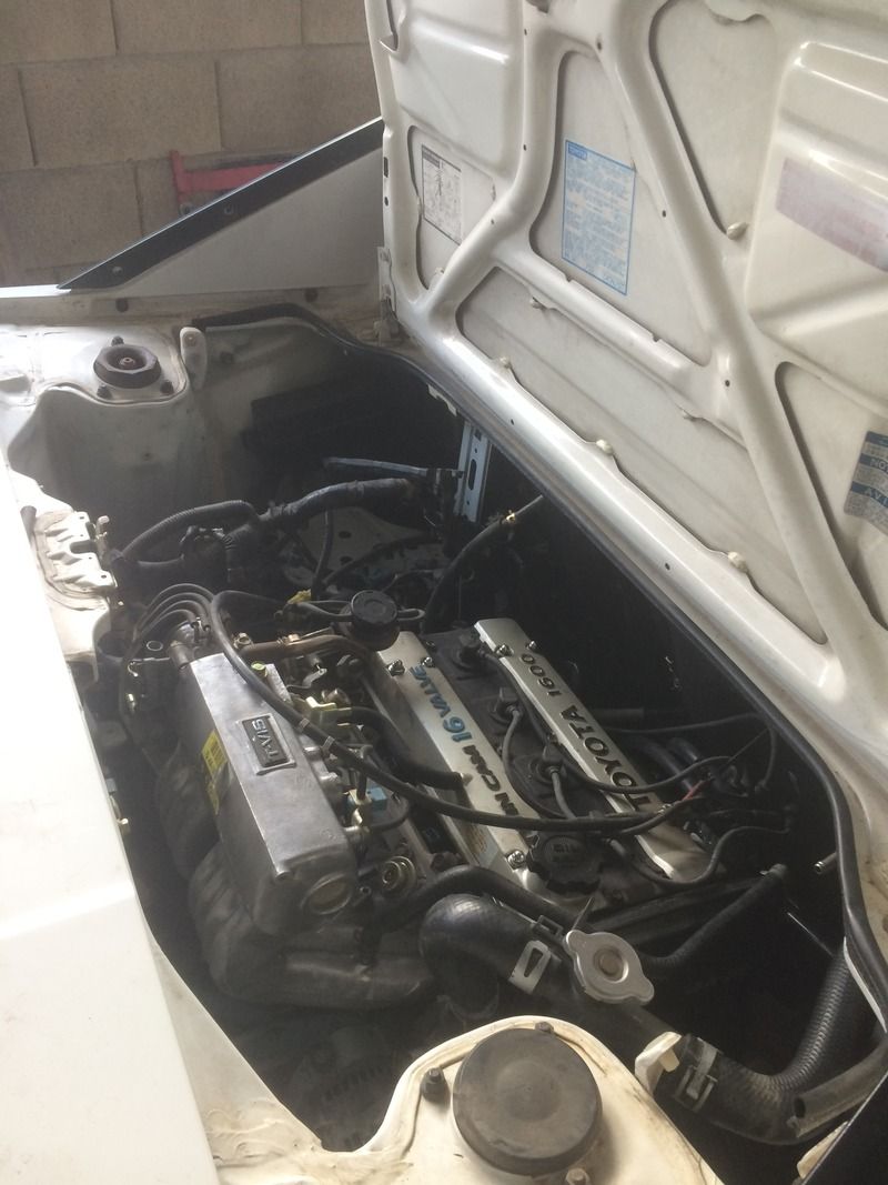

Car is ready, all the radiator and heater hoses are installed.  New oil cooler lines will be fitted after the engine is in.
Looks like there is enough room in there.
This is different....
The engine/trans stays on the ground, you lift the rear of the car, and slide the engine underneath.
When the engine goes in from the top and something goes wrong, the engine can fall and pinch your fingers.
When you are under a car which is held up by a hoist and something goes wrong...  you die.
...and just as I suspected, it fights you every inch of the way.
The firewall interferes with the distributor cap at the same time the intake manifold hits the axle, then the exhaust manifold hits the A/C lines and motor mount.
Once it is in, there is clearance all around the engine, and it looks really small in there.
