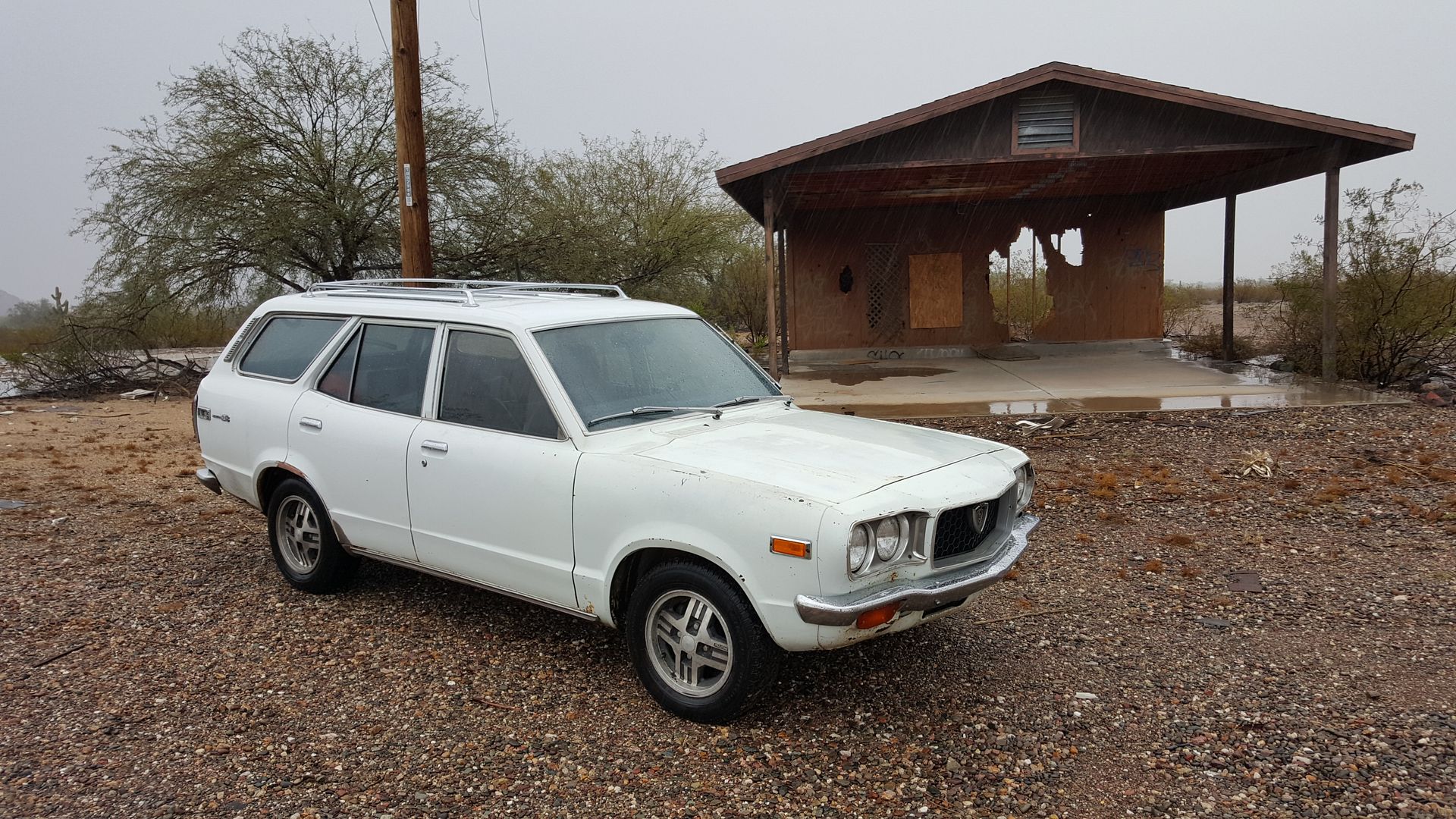

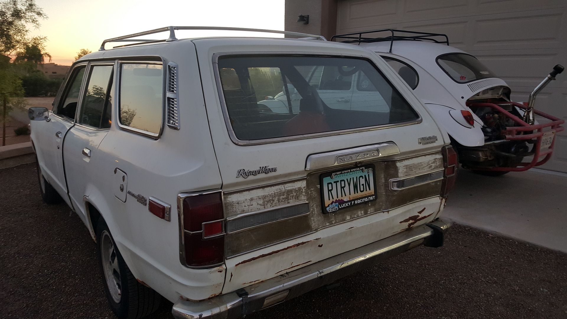

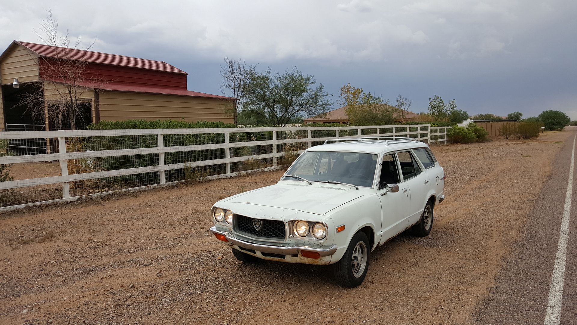

Since theres not much going on the forum ill share a project i picked up a few months ago.
1973 rx3 wagon.

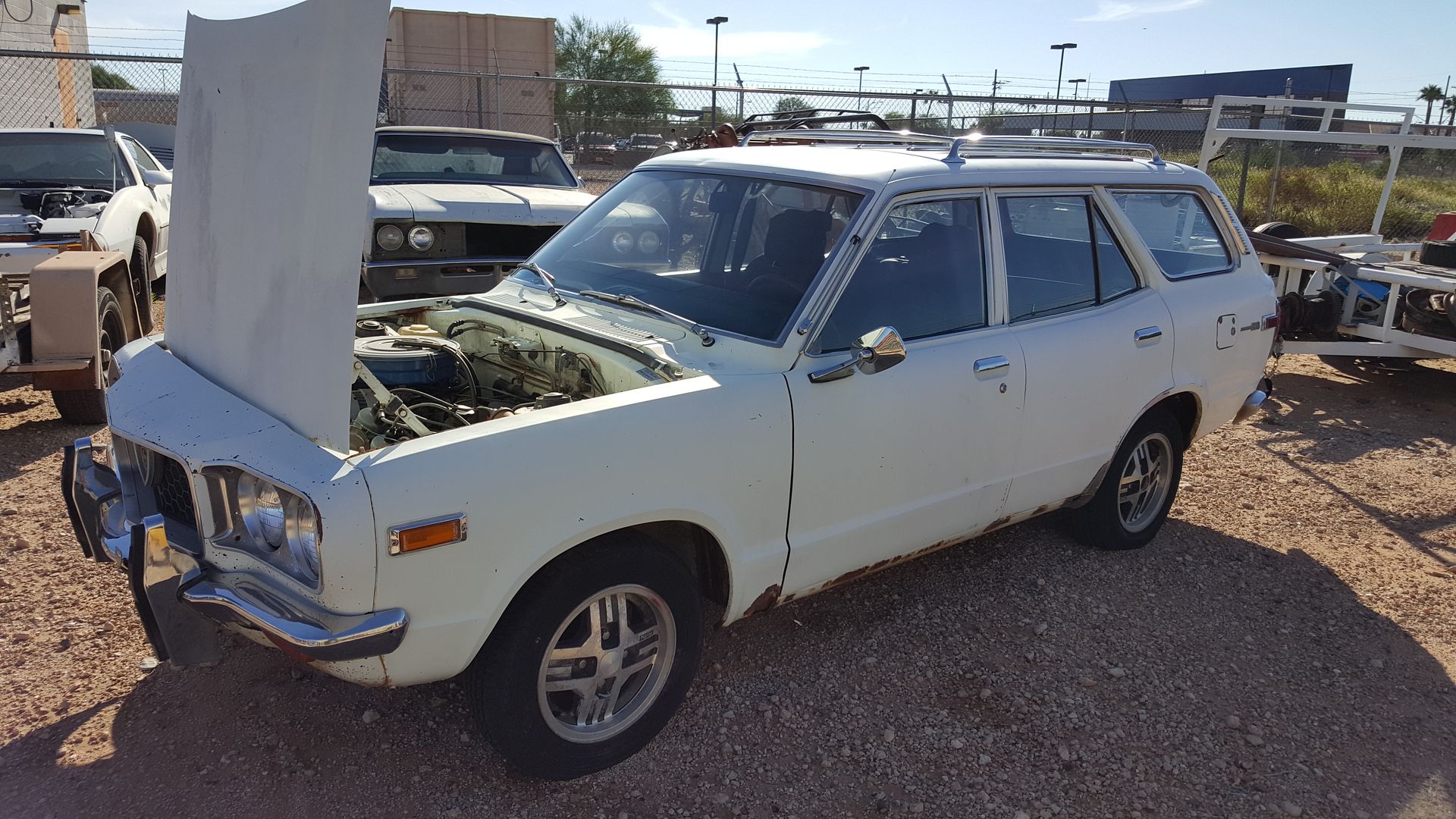

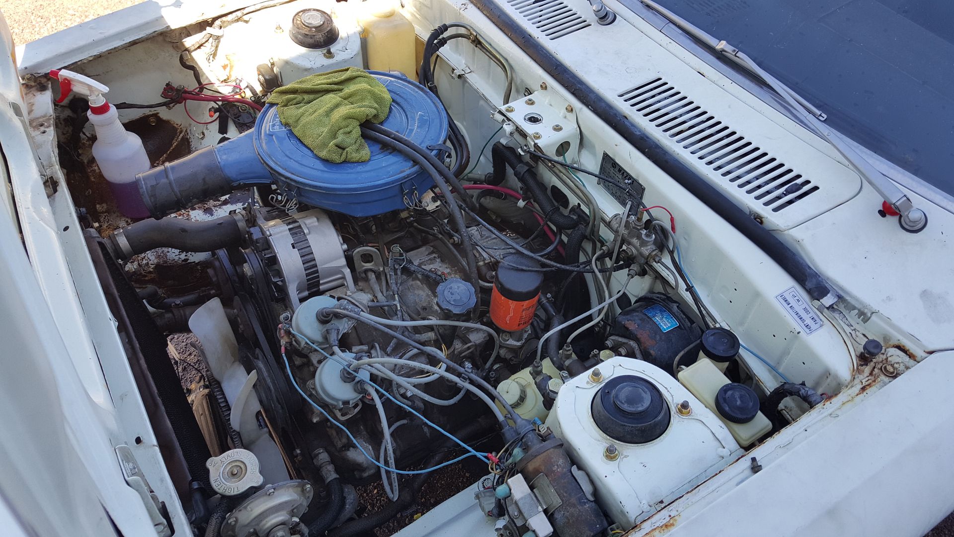

I picked it up, a car that sat for awhile.
Fixed a few things and dailied it for two months.
It was fun to drive, peppy and shot flames.

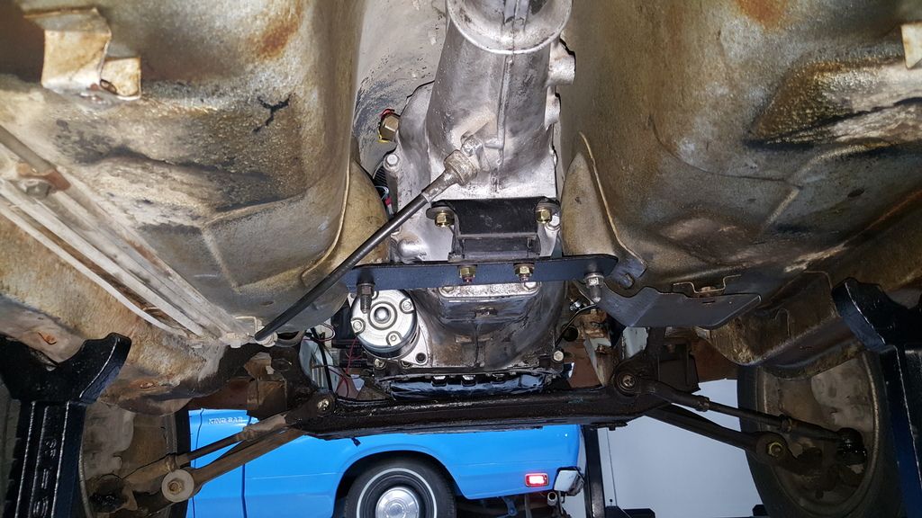

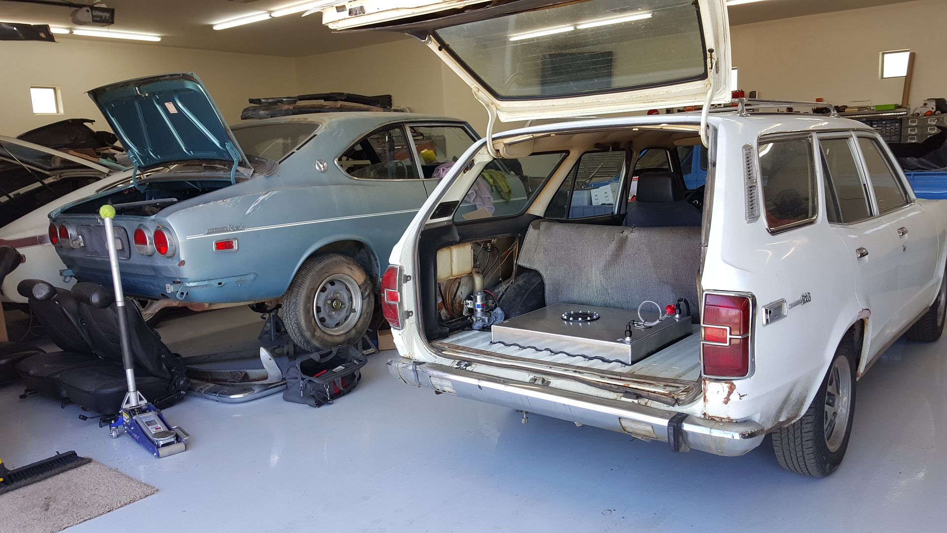

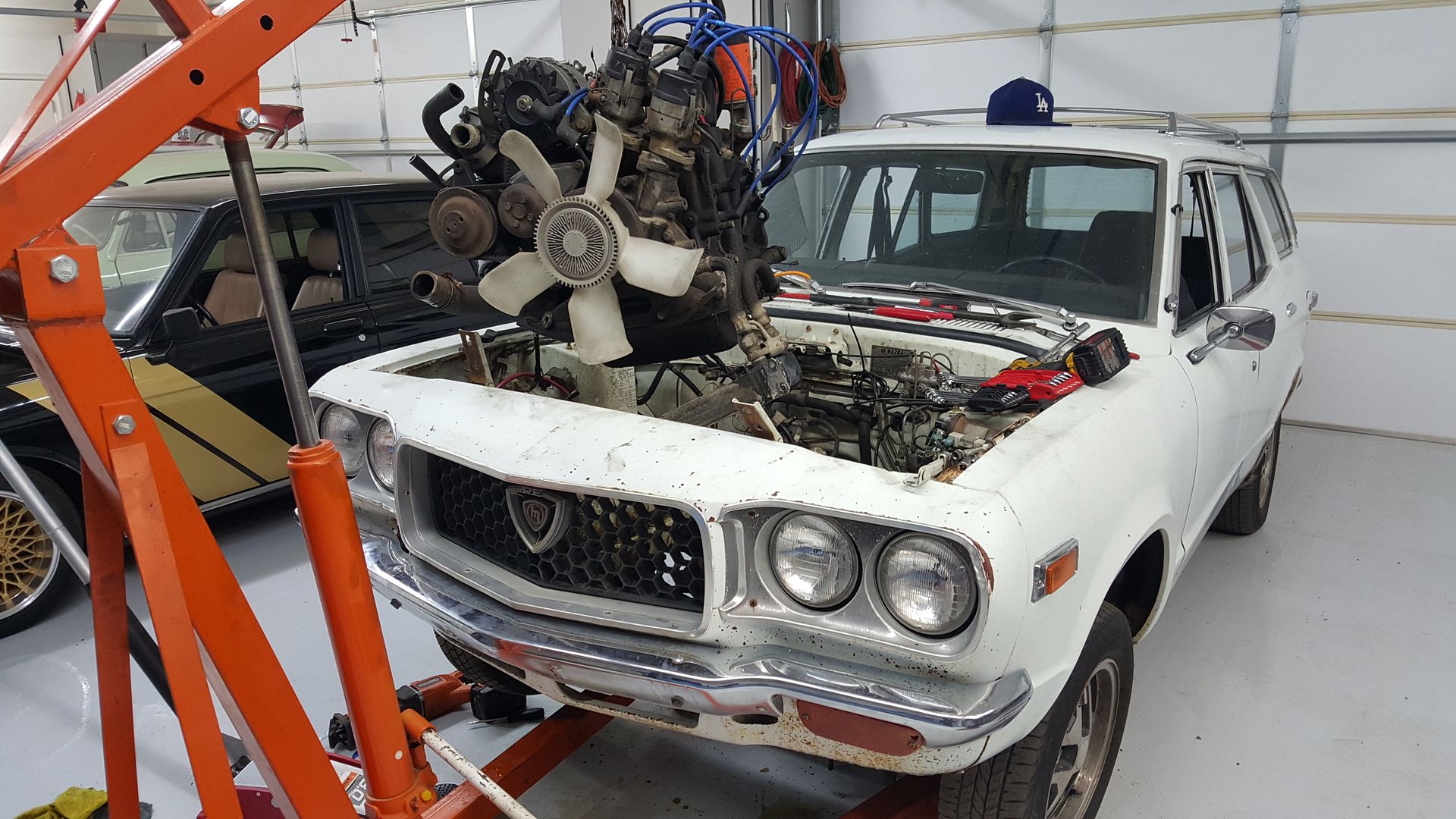

I wanted to have a little fun in it sooo i had a new engine built for it.

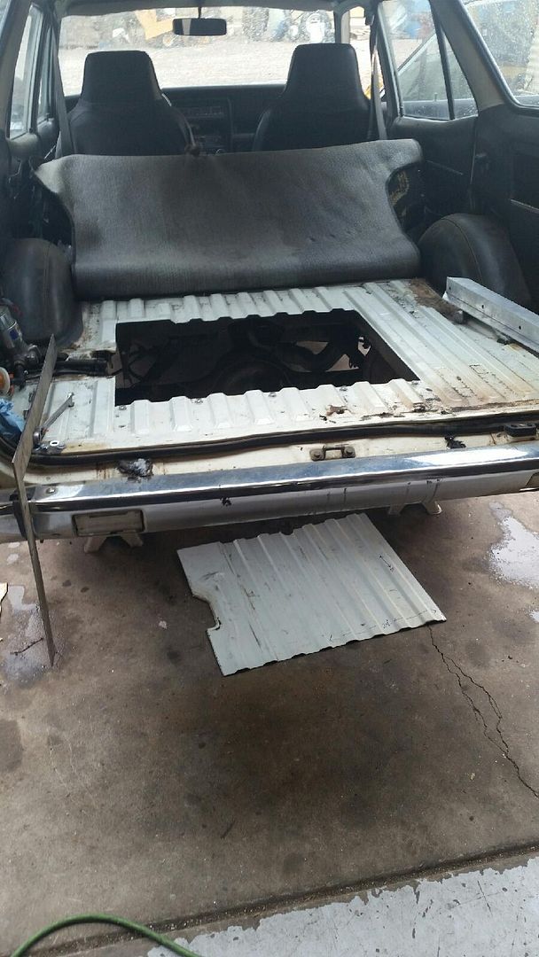

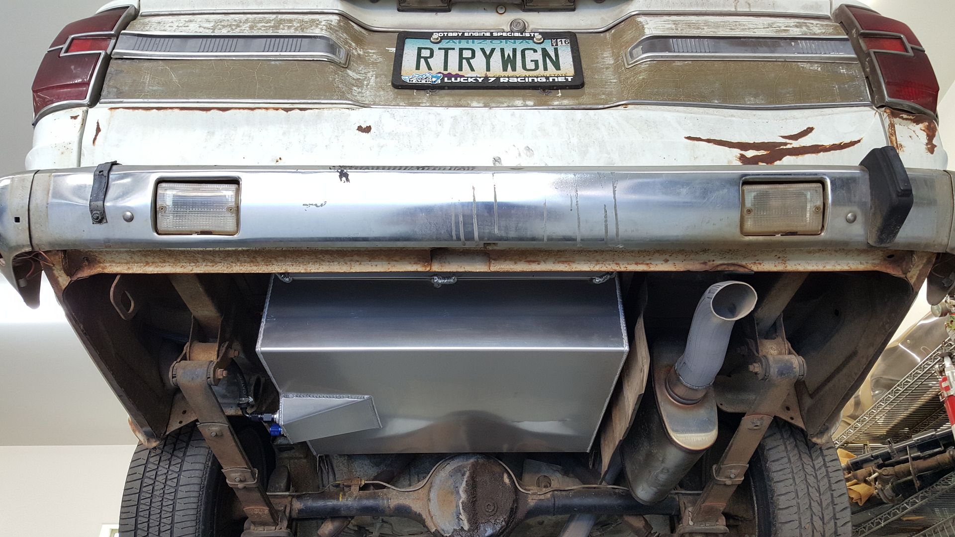

Bridge ported 12a, holley 650 double pumper, holley blue fuel pump, rx7 gsl 5 speed with an ACT clutch. The shifter housing was shortened to fit the rx3s tunnel
20 gallon alluminum fuel cell.
Shes almost done, jimmy d is building me a header for it.
After that i just need to get the driveshaft shortened, get an electric fan and buy premix and other fluids. She should be pushing about 230ish. Which is alot more than the 90 she had.
Here are some pictures of the hooptie
I took her out to that trip to bagdad with the datsun guys before i took it apart. Kept up with all the Z cars easily. She hit about 135 which was really impressive for an old lady car. I cant wait to finish her and drive it with the new engine.

That is super cool, glad to see most of the trim and small details are there. Props for building a sleeper too, especially a wagon!
Did you add any baffling to the fuel tank or have a surge tank?
Toywagon82
  • Posts: 278
Re: Meh

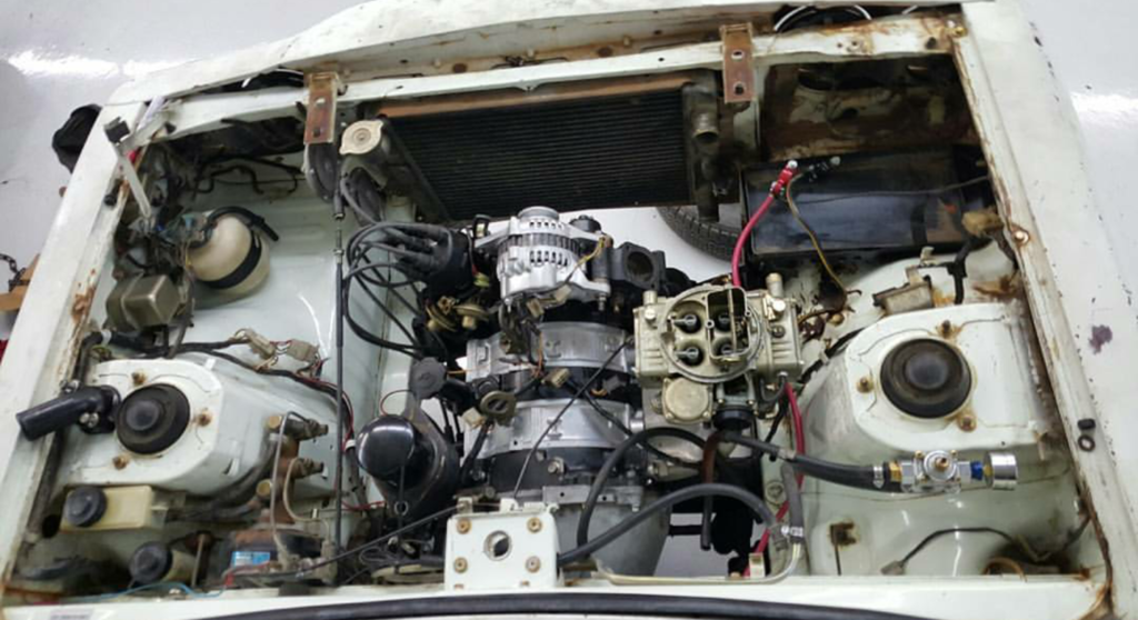

« Reply #4 on: February 26, 2016, 11:28:24 PM »
Thanks man! Yeah i was excited to see it was fairly complete.
I didnt add any.
Here is an update.
Holley 650 mounted and jimmy d finished the header. Shes almost done!

Thanks phil!
Well rosies back home and running.all thats left to do is have my driveshaft shortened and find a throttle cable. Oh and have the exhaust redone.
