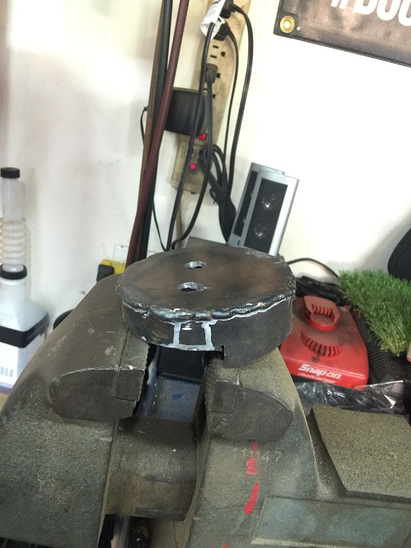

Getting a head start before the motor gets here getting the engine brackets cut out.  I will also be converting to a manual steering rack set up.

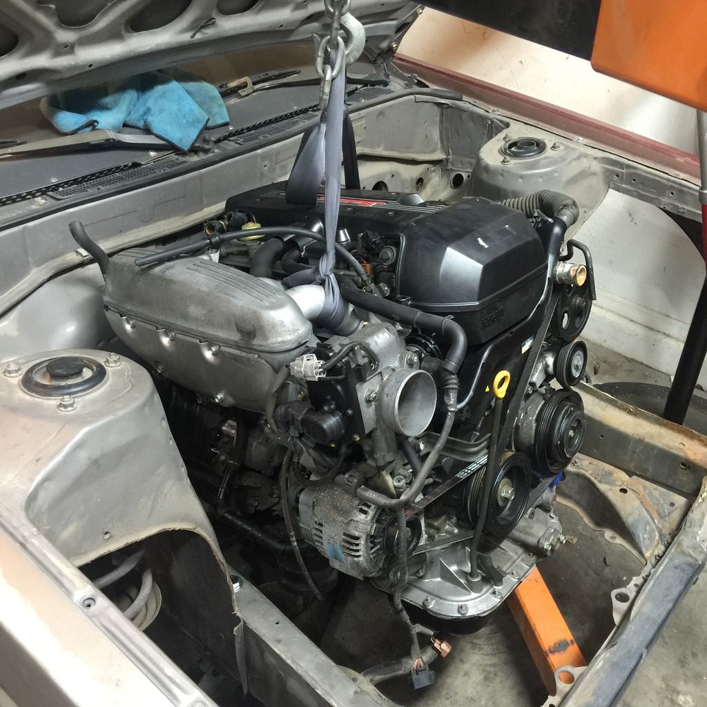

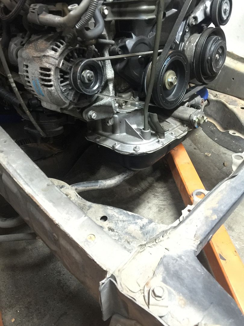

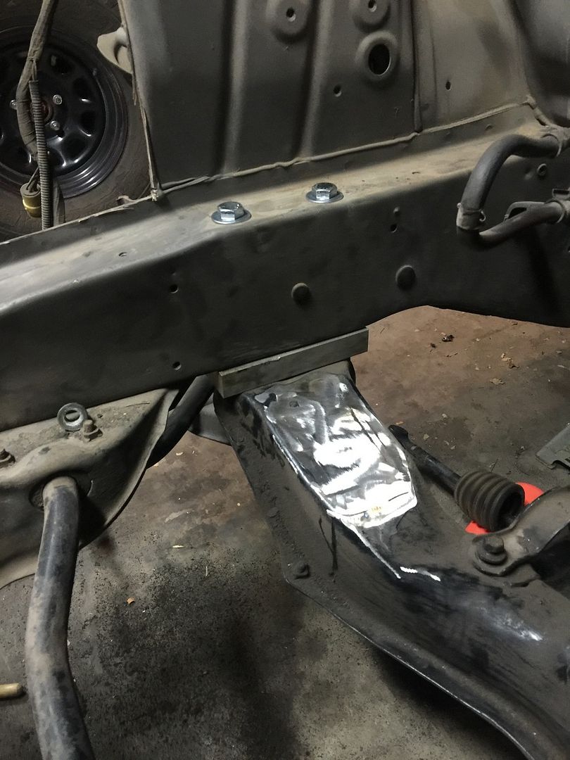

Tonight i made some 1 inch spacers for the front subframe and also set the motor in to see what will have to be moved.
Swaybar has interferance with the oil pan so i am going to take it out for the moment and see what i comw up with.
What i have so far is plenty of room to the firewall about 2.5 inches.  I didnt put it right up against it because the shifter was already moving to far back.  I will have to clearance the rear of the oil pan to gove room for the rack i am putting a manual rack so i should have no issues after trimming.  The rear water outlet i ordered a billet piece that is lower profile and deletes the throttlebody coolant lines.

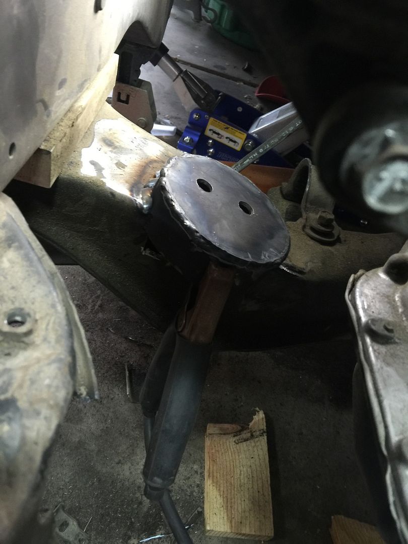

So today i finished the driver side engine bracket.  I had to order a trans mount since my trans was missing mine.  I have no idea how long it will be for it to get here i ordered through rhd japan.

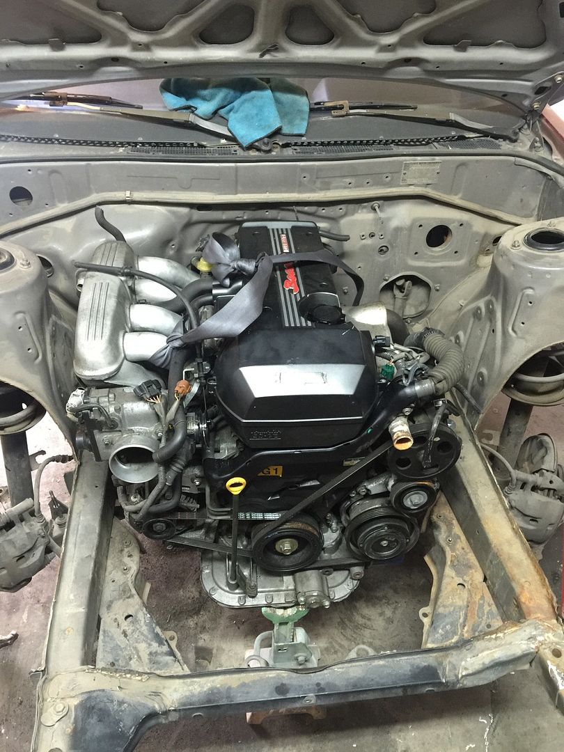

More than enough rack room
Final sitting location

Are those just hardware store bolts holding the front subframe on?    Do you think thay will be strong enough?

The bolts are just for test fitting I will order 10.9 bolts when it comes for reassembly.  I need to mill down my spacers about 1/8inch and I think that will be complete.
