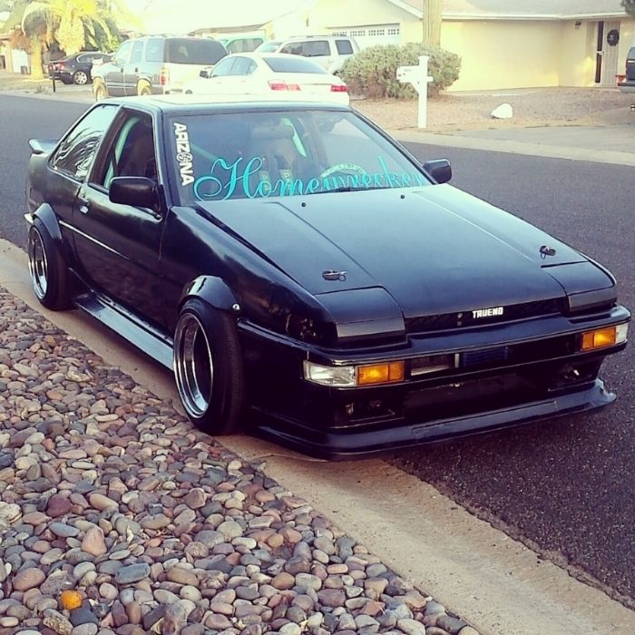

The car

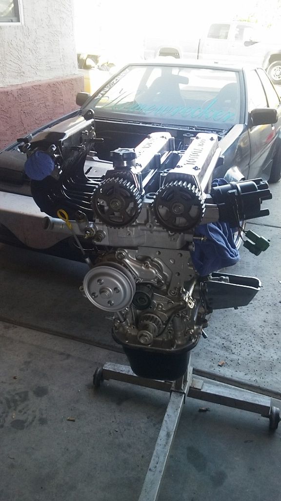

Where it sits right now
So far the list:
Block decked, honed and all tolerances checked and polished the crank.
Phoenix Cylinder Head did the headwork for me, new valves, springs, 3 way valve job and all the other fun stuff
King rod, main and thrust bearings
NPR piston rings
OEM overhaul gasket set
OEM head bolts
Gates timing belt and tensioner
Fuel injectors were all rebuilt
I shaved the TVIS badge and a couple other ugly spots on the intake manifold and had it powdercoated
I ordered a distributor cap and rotor but the cap doesn't match up so I need to get another. I also got an OEM throwout bearing and ACT pilot bearing while I was at it. I will update more as it goes!
