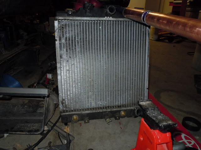

Some pics of new stuff to keep cool at the track.
Replaced this old thing.  1in 1 core stock Civic unit.
In goes the new Mishimoto.  2 1/4in 3 core.  I had to cut off the stock tabs and make completely new mounts, spacing the radiator further back since its so thick.
Oil cooler with brackets and fittings welded on by Future Fab.
Mocked everything up.  Painted the brackets off the car.  Just need to do some final cleanup touches.
