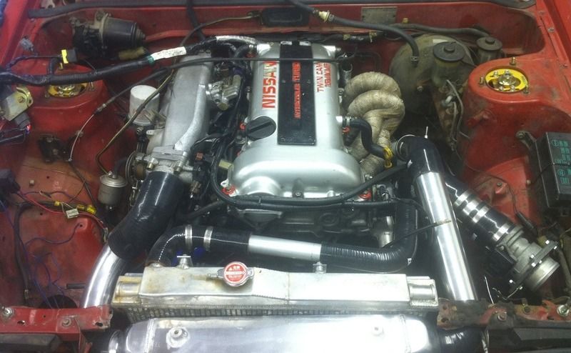

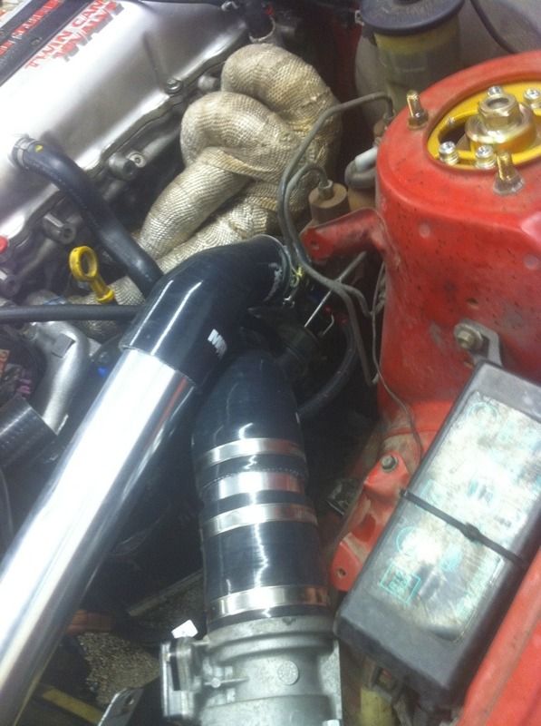

Well, it's 2012 and the way of the fmic is dead and gone. All the cool kids have v-mounts or trunk mounts, and us broke ass busters are all going hmic/mid mount..
I bought a piping kit with all the combinations of pipe I "might" need and turns out I should only have to use 2 pipes haha. I'm going to start with a 90 reducer off the throttle body into a 90 toward the intercooler. i may be able to go 45-45 though. Definitely can with a freddy manifold.
The driver side is just a straight pipe, if the sr outlet is where a ka-t turbo outlet would be, we are money.
(It's very similar to Bryce's without getting rid of the headlight motors/linkage.)
I trimmed the passenger side hole after taking that picture so the core was able to sit higher/level. Plus I couldn't hold it up and take the pic at the same time. Its not blocking the entire radiator either, even though it is larger then what I thought, I want it as high as possible.
Get aluminum sheet for ducks to run off the top intercooler mounting bungs->hood, a lower one against the radiator support->bumper, the intercooler brackets will be down there too, and side will most likely use the 3 bolts off the headlight motors all sick. Sheet sheet sheet.
Cardboard will be my friend, (so will anybody with a tig)
A problem did occur since my side radiator mounting brackets had to be removed for the piping to be ran.
I need a top brace for both cores, probably going to have to ghetto rig pieces of steel from the intercooler to the edges of where the upper radiator support use to be, and run even worse brackets from the back of the rad where the shroud mounts to, over the top to the intercooler. It would work but be so gaudy.  Anti-dan 5000
Mounting it to the motor isn't an option unless I go back to uti, only acceptable excuse.  ;D
Toying around with the idea of getting rid of the chassis harness in the engine bay. But it's like creating work for myself. I'm most likely am spraying the bay black or super red (might fly brinkin out wit dem spray can skills) and it would be nice to keep it clean.
Looking at all my gauges I have just enough room to fit them all in a stock cluster.
but I dislike the plastic tubing they give you for the oil pressure gauge, being the same as the tubing for boost gauge. I read to use 1/8th copper line instead.
Also super impressed about the fitment of these fans on the shroud:  :P
The shroud is pretty nice but they tried to go big or go home with the fans.

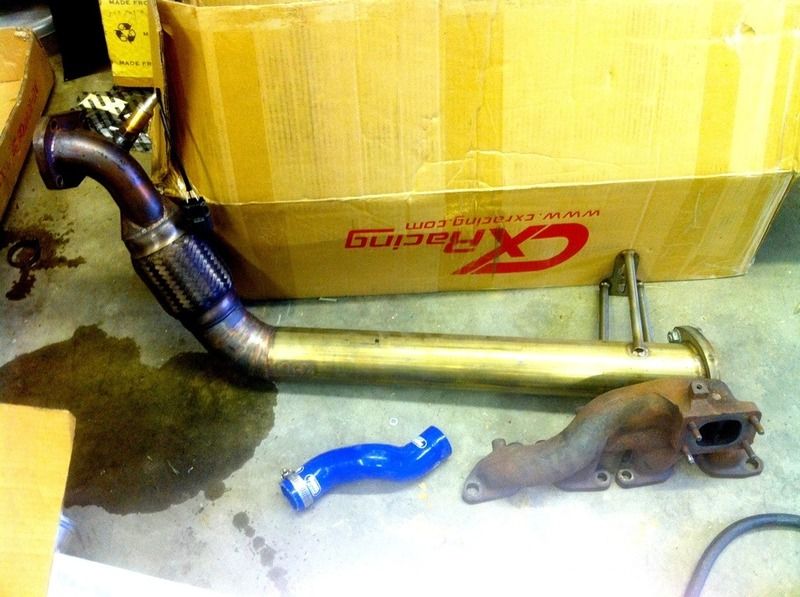

Power By Max 1 piece downpipe- My favortie part of this deal, use to be 400$ untill they mass produced it.

Upper Wiring Harness from Wiring Specialties- Not new wires on old connectors, not new connectors on your old shitty harness, ALL FUCKING NEW. From wipers to a.c. all plug and play, Hella expensive but very nice.
greddy oil filter relocation- clamps made to look like an? biggest waste/gamble for 266$ new

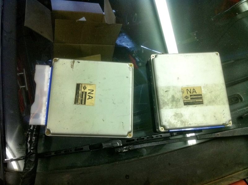

extra ecu- NA ecu's are supposedly pretty rare, he planned to go nistune so he bought a spare?

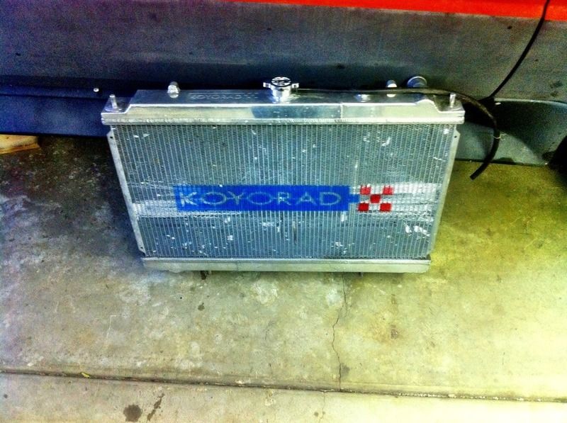

Before we even took a test drive I asked about the radiator, he said this was a "swap" for sale and he was putting a ka in in the mean time to drive it around if he wanted to. He said yeah, you can either have this rad or the other s13 one inside. I was like, no this one is just fine.. holding back evil laughter. KOYO FOR FREE BITCHES.
It's way nicer/newer then mine but you'd have to eliminate the lower mount on the headlight in order to run/fit it. SELLLLLL

and this is why, he pulled the box with this extra parts in it, showed me the extra ecu from across the garage and then said..
Oh and heres the power fc, i look up and see him holding a commander, and I am like THERE REALLY IS A GOD AND HE LOVESSSSSSS MEEEEEEEEEE. So yeah, if its the right ecu for a kouki 14 i'll keep it, if it's not. I'll sell it for 750 bucks. Either way I'm sooooooo stoked.
