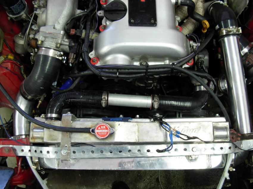

Here is a better shot of the bitchass hose. But mainly showing off where I drilled and tapped for my cts in the water neck.
I flipped this pipe upside down so my bov would be hidden, and I think thats the only way it would fit. But now I have to adjust it blind because I want it harddddddddd. You can see I need a shorter filter or to cut away the inner fender/core support to get enough room to fit another piece of pipe and a coupler in there for a recirc.

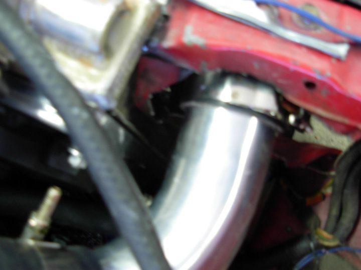

The 1" fitting I got is for a different Greddy I guess, so the hose is going to have to be pretty big.
Didn't get a shot of it. that fan ground will be redone and hidden eventually.
"Really good hoses, really bad brackets." If I was in AZ it would be future fab'ed up. This will make do for now.

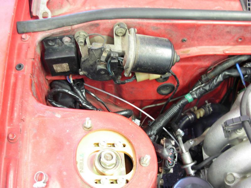

Mounted this box thingy, ziptied some wires, stared at my fpr, cursed how ugly that boost sensor pipe is, poked my coolant reroute hoses with a stick, you can see my igniter and filter ghetto-fastened.
That whole area alternator back is a mess.
Trimmed this hole so it wouldn't rub through the hose. I do realize I'm rambling at this point but I did a shitload of stuff to get this car ready and I don't overstand how people who don't have to spend 200$ in gas and drive 10 hours to work on there cars can't make events.

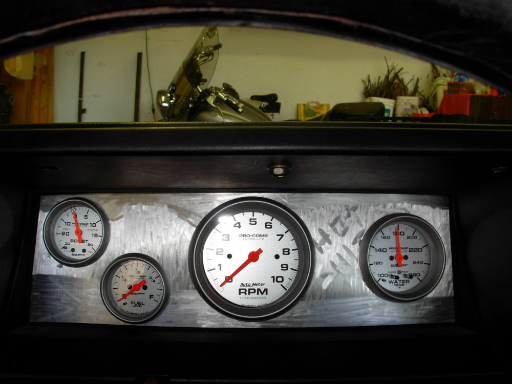

Hand cut and dremeled aluminum, handcut the plastic backing, holesaw and file the holes, mini ghetto wire harness because I ran out of butane for my soldiering iron. and stuff all that into the car.
It sucked major dick, and I didn't hook up the fuel gauge yet because I want to be 100% on the wiring for the level sensor. Didn't have enough time to program it either way.
Still got the 3 most important gauges done, I want to fit a 2 5/8ths oil pressure in there but the material between the gauges would of been so thin and the material itself was the thinnest gauge I would use for this. It'll probably go around my radio switch panel area.
The wide band will go in the unconnected left air vent which I think how Dan is doing it? I accidentally picked it up instead of my horn button and stuck it in the middle of my steering wheel and it almost fits.
HOW RICER WOULD THAT SHIT BE!?! Too much to bare..

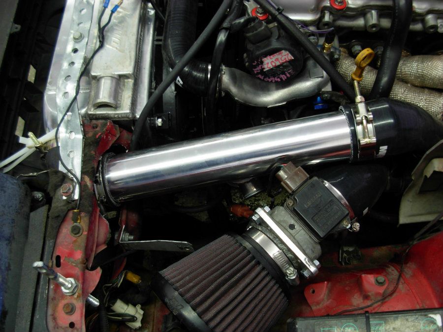

Bought some over priced racing supply's from pegasus. I figured out how my intake can be recirc'd using the technique efrain first had in this car with that green foam. Also got hose/wiring insulation.
My bumper rubs my drivers front tire without the lower bracket there. UGH

I'm thinking of hiding the ecu on the backside of the glove box.
Should be pretty trick.
