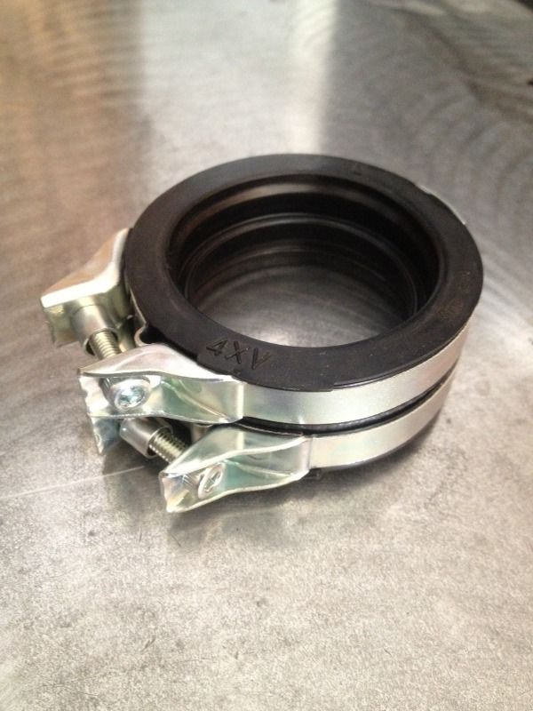

Nope.  The clamps are over $100 for all 8 through ride.  I gotta check some other motorcycle parts stores. I'm using a single hose clamp per runner for now.  i don't really like it, but the clamp is almost as wide as the couplers/joints so it does hold quite well.

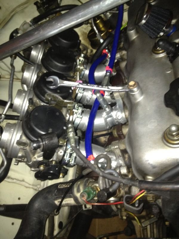

JimmyDE!  Welds might not be as pretty, but everything fits up like butter now!
Ordered some clamps from Ride Now Peoria, since the chandler store ordered the wrong parts, and then I never got back around to it.
Everything is installed, waiting on clamps.  Tho, it feels much more stable than before even without and clamps on it.
You can see my hideous exhaust here

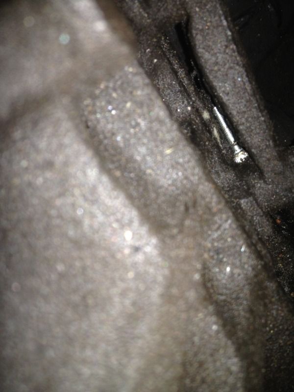

Clamps came in last night while I was at work.  Picked them up today and got about an hour of wrench time in...  I say hour, but 20 minutes of that was trying to get a bolt out, that had perfectly fell between the block and the bell housing support bracket.  Fun stuff.
I got the clamps on with the exception of the last one on cylinder 4, I just ran out of time, and it's a bitch to get to.
Much beefier,
After I got it dislodged, but not out.  This was fun getting out
But here she sits now.  One bolt away from driving.
