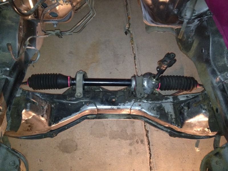

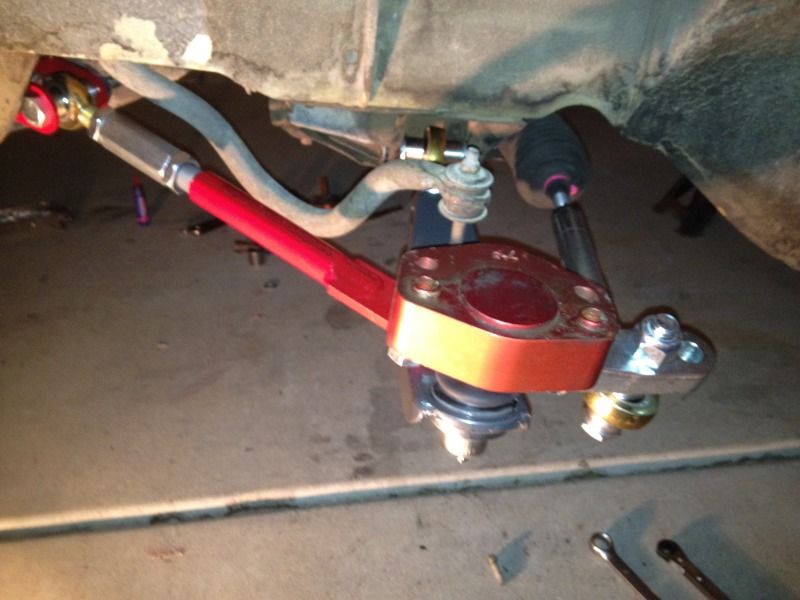

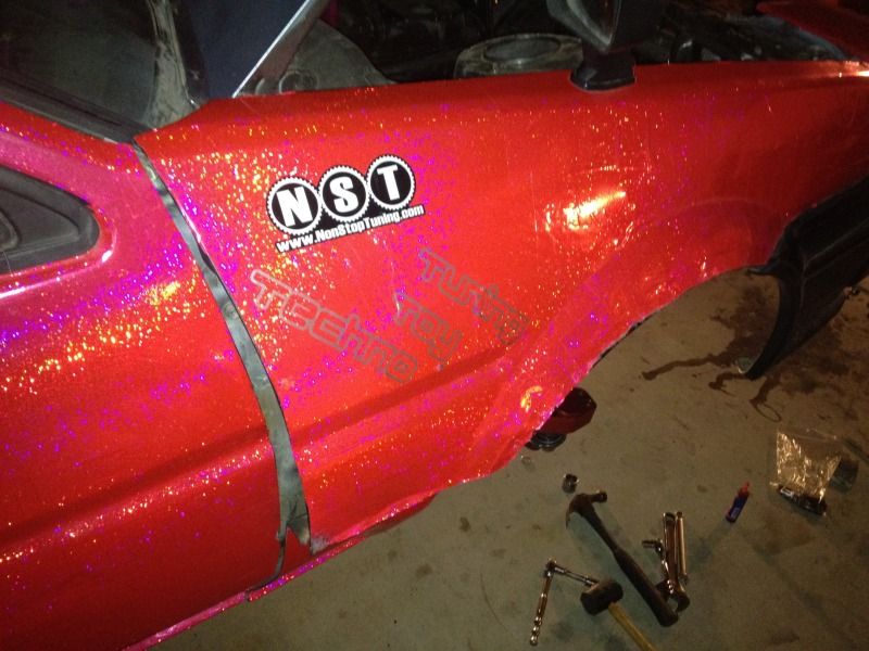

Added horsepowers via stickers
and this stuff too

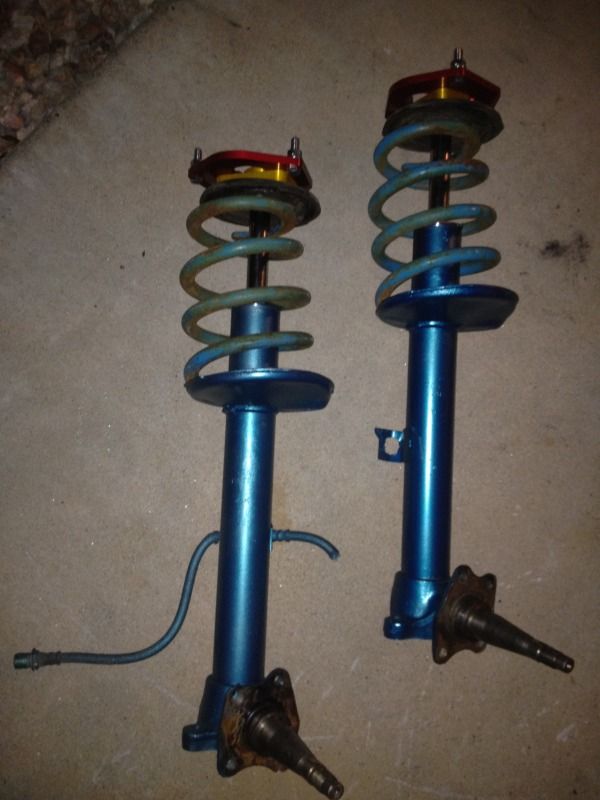

T3 camber plates, T3 Tension rods, T3 LCA's, T3 Knuckles w outer tie rods T3 NCRCA's, AW11 Manual Rack with NST spacer, new ties, nearly new boots.
slight issue with the knuckles.  they need a small bit of notching to actually fit the bolts for the struts in so those had to wait....  but they are assembled.   Painted, Strut tube spacers, KYB AGX SW20 shocks, TRD 8kg springs, T3 Camber Plates.

How ever did tighten down the bolts on the tension rods with such little clearance?  8)
