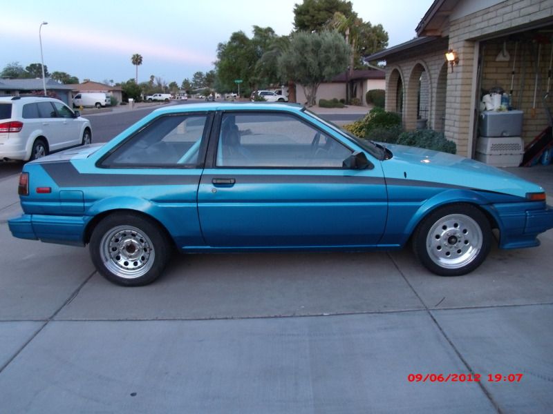

I took the 1JZ corolla to speed world saturday night.
It ran way faster than it ever did...  then it broke.
I was on street tires because the last couple of times I took the car out, it did not go near fast enough to need the race tires.
My LSD rearend is weak... It won't spin both tires... even old street tires, so I could spin one tire 3/4 the way down the track.
On one run, I got decent traction and ran 14.04 at 103 mph.
Then a few runs later, something let go... coolant all over the place, steam in the car, instantly fogged up the windshield at almost 100 mph.
There's coolant on the headlights, inside the car, everywhere.  Can't tell where its coming from right now.
Since it hasn't run a 13 yet, I can still take passengers and don't need a helmet.
That probably won't last, as soon as I rebuild the LSD, the better traction and race tires should put me well into the 13's.

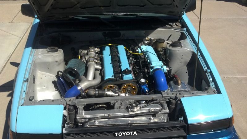

« Reply #8 on: October 07, 2012, 11:12:12 PM »
How much did you space the front subframe down to fit the motor and the hood closes.
Jsp sr spacers are 1"
retfirdiikm
  • Posts: 69
  • Road's closed pizza boy
Re: 1JZ corolla at Speedworld
« Reply #9 on: October 08, 2012, 12:13:11 AM »
Ahh that would explain lol. What is the rear end setup? 4 link bars ect? Maybe a build thread? How is it leaving the line? Big thumbs up tho love to see stuff like that close to home.  8)
Regards
'95 Corolla 370k& ticking...
'80 2dr Corolla 6M,s366,W58,G series
« Reply #10 on: October 08, 2012, 12:20:53 AM »
None...
I made the lower engine mount brackets, and the oil pan is about 1/2 inch from the crossmember.  The rear of the transmission is as high as it will go, and the underhood webbing is smashed flat.
The hood rubs a little. but it closes.  It's a very tight fit in every direction.  The trans tunnel was hammered a bit, and the main pulley is 1/4 inch from the lower radiator support bar.  The radiator is in front of the radiator support bar, and installed backwards.  Lots of details..
