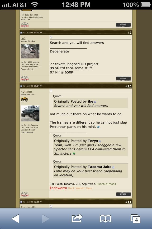

So I've been looking into getting a prerunner for the past two days and came across a really good deal on a 04 Tacoma but it wasn't a prerunner. I prefer the prerunner for its stance and trim as I'm sure most do but my question is can a regular Tacoma be converted to a pre runner or is it a different chassis all together?

http://www.toyotanation.com/forum/79-1st-generation-1995-5-2004/282032-can-you-convert-reg-tacoma-prerunner-stance.html
http://www.ttora.com/forum/showthread.php?t=121801
Quote:
Originally Posted by tacomasr4me
So not a simple deal of getting a junk prerunners suspenison pieces?
Nope... whole different setup suspension-wise
Go do some reading in the Desert Tech section. I'm pretty sure lift for 5-lug tacomas are discussed
"If you look underneath both of these trucks you will see immediate differences. The first thing that struck me was just how much smaller, thinner, narrower, and generally weaker a lot of the front end components appear by comparison to the Prerunners. The minis are just smaller lighter trucks. Before we bought our Prerunner I was considering lifting the mini. But once I had a look under the Prerunner it became immediately obvious that the Prerunner was the better one to build up. So we did the 4wd conversion, lift, etc. on the Prerunner and left the mini stock. It could have gone either way initially, until I got my hands on the Prerunner for comparison.
In the rear end the main difference you will notice first is that the Prerunners are spring over axle and Minis are spring under, which keeps them closer to the ground."
